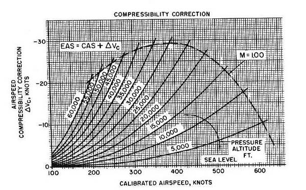

The answer is your AOA will need to increase to maintain level flight as you fly at high altitudes even if you maintain TAS or IAS. As is well known, at altitude TAS will increase even though IAS remains the same due to lower air density (fewer air molecules). While it's true that the airplane only cares about how many air molecules fly under the wings and into the engine intakes regardless of altitude and TAS, the relationship between IAS and the velocity and density of air molecules flying around the wings isn't constant.
Enter EAS or Equivalent Air Speed. The formula to convert IAS to TAS is:
IAS --> CAS --> EAS --> TAS
IAS = Indicated Air Speed - What the ASI indicates
CAS = Calibrated Air Speed - IAS corrected for instrument and position errors
EAS = Equivalent Air Speed - CAS corrected for compressibility (more in a minute)
TAS = True Air Speed - EAS corrected for density altitude
Compressibility is the term that describes the compressible characteristics of air. What this describes is how air can be compressed (in the simplest terms air molecules can bunch up under certain conditions). Most folks relate compressibility to supersonic and transonic flight, however compressibility is also a factor in subsonic high altitude flight.
The chart below illustrates how compressibility accounts for a loss in CAS as altitude increases. We know that lift can be generated by AOA and/or increase in airspeed. So if we lose airspeed and wish to maintain level flight, we need to increase AOA as we fly higher even if IAS remains the same.
http://www.flightadventures.com/misc/pix/EAS.jpg
Other related questions that commonly come up are why do we fly Mach instead of EAS at high altitudes, and what happens to AOA in level flight if you fly a constant Mach and at high altitudes?
Here are a couple of points to consider:
- Mach can be thought of as your airspeed in relation to the speed of sound. The speed of sound varies with temperature.
- TAS is EAS corrected for density altitude--where density altitude is pressure altitude corrected for non-standard temperature.
